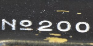

as for the engravings... parts seems filled with woodsmetal (the leica logo) and the number looks more like paint...

The style ("font") of the engraved number looks very odd to me, the numbers are too big. It is possibly done by an independent (non-Leitz) Werkstätte. This is strange because Leitz had the policy of not selling top covers without receiving the original cover and not after having engraved the original number in the new part themselves.

there is something bizarre with the numbers... the N° part seems ok but I think that the number itself has at least been repainted (or refilled with paint)

and here is the comparison...
Logo looks almost normal, but numbers are heavily overpainted ?
