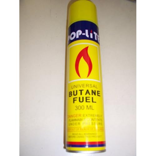

Benzine, yes! Our word is "benzina", a petroleum distillate. The trouble is, lighter fluid here, is: gas to the lighters like bic or such. Or gasoline, as we call it and also, gasoline, to the zippo lighters. Then again, the language terms may be teh trouble here, since we tend to ahve many names and designation to the same liquid, even if they are wrong. Exemple, the liquid used in petroleum lamps. We call it petrolleum, but it's not the real petroleum, it's kerosene, and also we used alcool, but the name we use is petroluem...
naphtha-gas
naphtha-gas
Lighter fluid is "the" fluid (naphtha), in tin can.
Lighter refill gas (butane, under pressure, dan-dan-dan-dadadan-dan, under pressure... ;) R.I.P. Freddie!), also fluid in tin can, but "spray" type...
Edit: One might argue, I use "naphtha" in distillated hydrocarbon manner...
