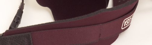

It's not that the Heliopan does not work at all, it is that it does not work as fully as the 486. The attachments below are two crops of test shots with the M8 -- one with a 28mm Elmarit that had the Heliopan digital filter, and one with the 50mm Summilux that did not. C1 using the current M8 profile with no changes. Converted to sRGB and jpg, but no other work in PS. There is some difference in exposure, but still think these should give you a sense and a reference point. The Heliopan clearly reduces the IR, but the camera strap is black in real life, and as it seems -- from the tests I've seen in Sr's part 4 -- you would get with the 486.
The information I had on the reflective qualities of the 486 is from what I had read in several threads on the Leica forum from a member who has a history of getting the info right. As I understand it now, the 486 filter may not be much different than the Heliopan in the real world -- everyone is trying to compare one to the other without having both in front of them -- in which case it's not great but not a red beacon either. Hope that helps.
As to using the Heliopan on my CZs, since I use a mkII, SR's test -- which uses the 5D as a reference -- tells me that I have no need for it. Amazing how much information we are all starting to understand and never expected to underestand about IR.

Your right, the Heliopan works but it is only about 1/2 as strong as the B+W 486. But that may be a good thing if you are attacking the purple/black IR issue on two fronts, the color profiling solution as well as the filter fix. One possible advantage of having a weaker IR filter is it would presumably result in less cyan "vigneting" with wide angle lenses.
