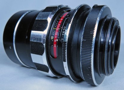

I have this Isco-Gottingen Tele-Westanar 1:3.5/135mm with M42 screw mount.
The lens is in good shape with clean glass.

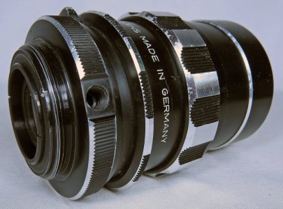

My question is: what is supposed to go in the empty hole with the threads? Shown in first pic.

That's where the cable release socket should be, but somebody has removed it. If you're wondering why the lens would need a cable release, it was intended to preserve the automatic diaphragm operation when the lens was put on a macro bellows. You would use a double cable release, one cable to operate the camera shutter, the other to stop down the lens diaphragm.
