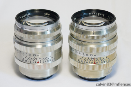

(Soviet) LTM ones will look like this:
The M39 one is shorter and has a pre-set aperture ring:
(At least, I think they all have the pre-set aperture ring - I may be wrong!)
And then there's Kiev ones, but hopefully no seller is stupid enough to get that mixed up with the others!
Assuming they're not damaged or mis-calibrated, all of the Soviet LTM ones will work perfectly fine on a FED, Zorki, or mirrorless camera with an LTM adapter. They won't work on a Leica, Canon, etc. due to differences in rangefinder spec.
The M39 ones will work on an early Zenit, on any M42 SLR with the M39-M42 adapter, and on any mirrorless camera with an M42 adapter via the same M39-M42 adapter (I've never seen M39 to mirrorless adapters - I guess technically you could find an LTM or M39 extension ring of the right thickness and use an LTM adapter?).
If you're willing to play around with weird gizmos, you can use the M39 ones on a screwmount Leica via a Focoslide or similar, though; I've used the M39 Helios-44 that way. That gives you infinity focus, and the pre-set aperture rings work a treat on that setup.
I can only assume any confusion here is because people (incorrectly) use the term M39 to refer to LTM and Soviet LTM (which are two different things!), when M39 should really only be used for the Zenit mount, in my opinion.
