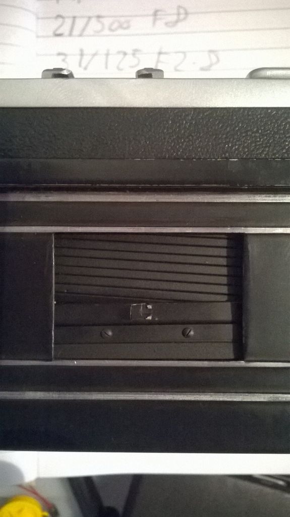

Hi I was using my Kiev 4a and it worked fine till I did a test blank roll with the back off and the curtains got crooked does anyone know how to fix it ? Or should I send it to fedka? I bought it from fedka

Your picture is not function. You may have a detached shutter ribbon?

KRaZiGLiTcH
Sorry here it is flipped

It shows a little pic torn in half icon, man. I don't know what to tell you. Does the shutter work? My shutter is a little tilted, but it works. If your shutter is tilted and doesn't work, it sounds like a detatched ribbon.

The curtains have crashed into each other. Seems typical behaviour on a Kiev shutter that is dirty/stick/hasn't been used in a long time.
Wait until somebody else chimes in, but if I remember correctly mine straightened out when the shutter was cocked, and only crashed into each other when the shutter was fired at particular speeds.

Maybe you could take the back film gate off to see what's actually happened in there. It's only held by five screws. That's what I would do if I had the camera.
Could it be because the top blind is not latching or capping properly when it gets released?
It may also sort itself out if you just wind the shutter again.

Ok I had a look and the left ribbon has snapped. Not sure why as I have only used 7 rolls of film

Probably old age as the camera is about 40 years old and you don't know what happened to it in the past. The ribbons can be replaced, best to have the pair done, imo.

Unfortunately the cla probably didn't include replacing the ribbons so the ones in your camera were likely the original ones. The ribbons aren't too hard to replace if you want to try and do it yourself. Although I have to admit that it gets a lot easier after you've done your first one.

Well I asked Fedka(Yuri) he said he will fix it for free so I'm going to send it his way. Instead of trying my self, I don't want to make it worse lol.
