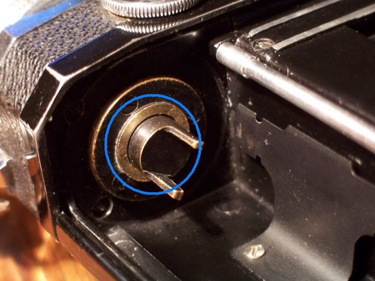

I am experiencing a problem of a different kind. My shots end up too close to the sprokets on the bottom, leaving a border on top. Also, I have trouble lifting the knob and setting it to the highest speed and changing from a high speed to a low one. Can anyone help? Thanks.

If it's any consolation Samuel, my Contax does the same (and if you've seen Robert Capa's D-Day shots, you can see that his did too!). This is a pain when I use a minilab because the automated process seems to scan/print from the centre of the film and also crops slightly, so I end up losing quite a bit from one side of each picture (and so the composition is quite different to what I'd intended).
I presume this problem occurs because the cameras were originally designed for slightly different (reloadable) cartridges. After investigating the problem I came to the conclusion that this little flange (circled in the picture) was the only thing stopping the film cartridges from going up a little higher.
I removed the rewind shaft assembly and took that part off of the shaft. I filed it down just a little (a millimetre or less), and that seems enough for the film to be now more or less centred at the film gate. I've since repainted it matt black & added a small spacer to the camera back where the cartridge sits to make sure it's held up in position. I haven't film tested yet, but hopefully it'll do the trick.
Thanks Wayno! Robert Capa is my hero. Anyone charging down a ramp facing machine gun fire, artillery shells and armed with two contax II cameras and taking pictures while trying to stay alive earns my undying respect.
I find that it isn't the same for every shot. Some is worst then the other. So now I have shutter problems as well?! It's not as bad as to obscure half the picture, but it takes of the top 1/15th in the very serious case.
