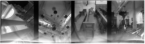

After using Paterson plastic reels and tanks for a couple of years to develop 120 film, I decided to get a Kinderman stainless reel and tank, because the hassles of loading the Paterson reels were getting to me. Today I developed my first two rolls (Delta 400) with the Kindermann -- disaster!

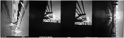

The first roll had a irregular gray blotch all down the middle, lengthwise. I thought it might be due to incomplete washing, leaving some anti-halation dye on the film, but further washing didn’t help. The second roll was worse, with uneven development at the edges and the bottom half much darker than the top, the entire length. (Will try to attach scans.) Taking no chances, I did a 3rd roll on my old Paterson reel and tank -- came out perfect.
Anyone have any idea what might have happened? I used the same chemicals and agitation routine with the Kindermann as I normally do with the Paterson. (Developer was Prescysol EF, which is pretty flexible.) The Kindermann tank seems to allow much less sloshing around, being smaller. Could that have something to do with it? If I can’t figure it out, I’ll go back to the Patersons for good -- it’s too risky otherwise. Grateful for any advice...

it looks like the film was not the reel properly.
it was not totally isolated on the spiral of the reel on one side at the film's edge.
S.S. reels have to be loaded with more care than the Paterson type reel.
Weak fix and insufficient agitation caused the streak down the middle. Refix in a tray and rewash and it will be fine.
The blotches on the second roll are insufficient agitation and/or not enough developer inthe tank. This is a total loss.
Best practice with stainless is to prefill the tank with developer and drop the reel into the developer in the dark. Rest of process with cap on is fine. This is not to say you can not pour developer in thru the cap, but you do risk marking the edge where it flows down. The Paterson fills evenly bottom up so the problem does not exist.
Paterson has a lot of head room for the developer to go at the top so two inversions is sufficient. With stainless, you must use no more developer than required to cover the reel to preserve as much space at the top as possible. 5 inversions or two with rotation during inversion are required.
If time is required to place the cap on the tank, lower the reel, remove and relower two times. This is initial agitation. Then cap and wait for the next cycle.
Don't give up on the Kindermann yet. They're especially nice tanks.
