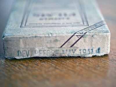

That being said, I found some Kodak Super XX that had expired six months before the Japanese bombed Pearl Harbor, that had been stored at room temperature, and I was miraculously able to get an image out of it.
