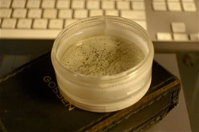

I finally got the shutter and aperture clean and working properly on my KAS2 after nearly a week of cleaning. How dirty was it? The picture below shows some of the dirt and debris that was removed by my "techno-pop sonic thump full immersion" technique:
Shutter crud from Konica Auto S2 by Greyscale3, on Flickr
I may yet get to run a roll of film through this camera.

That looks like the shavings from an electric razor. Fascinating, yet gross. I'm glad you fixed the S2!

That's a lot of muck !

That's very cool Greyscale.
Could you possibly explain your "techno-pop sonic thump full immersion" technique a bit?

Jack, if you use a thin piece of rubber, like from a dishwashing glove, you should be able to get enough grip to remove the knob on top of the advance arm. If you don't get enough grip that way, gentle use of a pair of padded pliers may be necessary.
My unconventional method for cleaning the gunk was to place the camera lens-barrel down in the custard cup seen in the photo above, with the cup filled with enough naphtha (lighter fluid) to completely immerse the entire shutter assembly (remove the front element first, and de-solder the connections to the light meter sensor). Then I put the camera ontop of my stereo speakers and tuned in a techno pop/electronica station on my digital cable box and turned the bass to max. Even at low volume, this caused a constant, gentle agitation of the solvent, and gravity allowed the debris to drift to the bottom. I would exercise the shutter and aperture every know and then, and gently swab dry the shutter and aperture blades to loosen any remaining gunk, then repeat the process several times.

Very clever contraption, or should I say gunktraption. Your information helps tremendously since at the moment I have the front and rear lens elements out and am attempting to flush the aperture diaphragm and consequently the shutter as well. Beautiful.
It seems that partial swabbing of the blades just doesn't cut the mustard.

I was successful using a variation of Greyscales sonic immersion.
However, rather than using Bass vibration I put the cup bath wrapped in a plastic baggy right on top of a fan tilted straight up, since it vibrates at a smooth consistancy.
And it did work. Much crap came out and the shutter/aperture is running nice and snappy now.

Oh, and to honor Greyscale's innovative vibrational cleaning method, I offer this photographic testimony of its efficacy.
