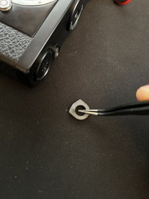

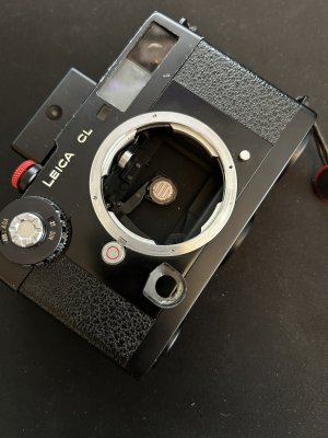

did you figure this out? it was pretty simple. i just used an angled thin tweezers and pried. there's glue underneath and you can see how my cover was slightly bent as the tweezers pulled up on it.

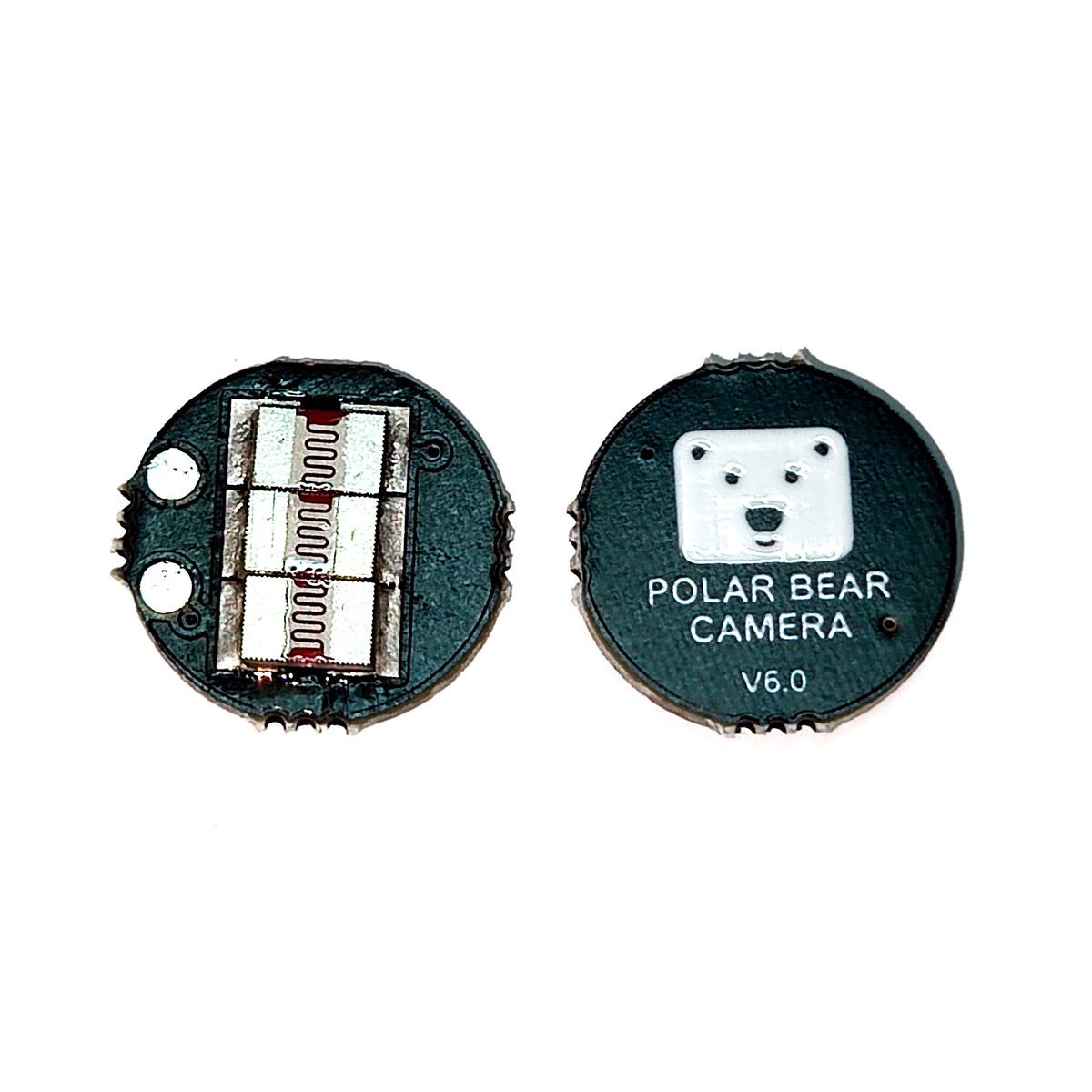

Where does one get a new cell from? My meter is dead but the circuity is fine because the battery check button moves the needle as it is intended to.
