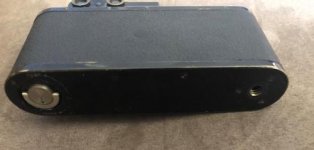

The bottom plate has "open/close" engraved in English. Was this normal for Leica exports of that time?

Yes, open/close, 1/4" tripod screw, 'Germany' in flash shoe, all normal for an export model at the time.
Very nice camera & lens !
I have a II (s/n 77xxx) with 11 o'clock nickel Elmar (s/n 99xxx).
Can you share a picture your with the lens removed, so we can see the lens-mount ring ?
Thanks !
