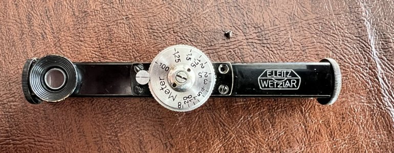

Leica Leitz rangefinder FODUA adjustment
Duofold RF
12:15 PM
Oct 7, 2021
565
USA
If the infinite horizontal alignment is off, loos the nut with two holes adjust the center slot screw, then tight the nut. If you disassemble the rangefinder pay attention to the size of the 4 screws, one of them is shorter should be in this location where the rangefinder arm is located. If longer screw placed in here, you will have disengaged double image at the near distance. The vertical adjustment or replace the mirror requires remove the end cap, adjust fine set screws.
