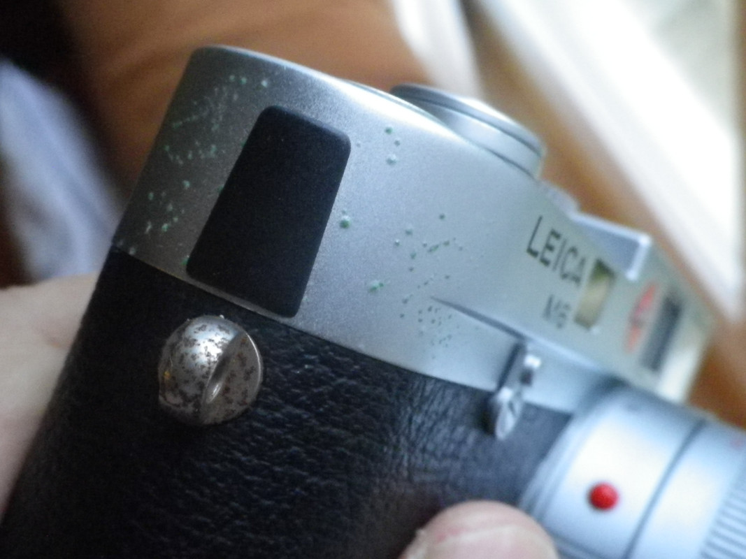

robertofollia
Sorry for reviving such an old thread.
My M6 has developed a very nasty bubbling on the top plate. I have not seen any other post regarding re chrome or re plating besides the present one and this one:
https://www.rangefinderforum.com/forums/showthread.php?t=15634&highlight=rechrome.
Is there anybody I could send my top plate to be replated?
I am not safe with the platers in auto industry. In Spain they are closing one after the other and such a small part as the top plate could be lost or damaged.
I don't want to send it to Leica as they would simply ditch my top cover and put a new one instead, I want my original cover to be restored
Will try to contact CRR by phone in case they accept my M6 top cover to be sent to them

Ronald M
Your bubbles are the result of impurities in the zinc top. Replate is like paint over rust, it comes back.Sorry for reviving such an old thread.

robertofollia
Thank you so much for help. I thought a good bath in whichever chemicals (don't know if acid might eat zinc) could help remove the impurities or at least neutralize them, and then surface preparing and replating could solve it or minimise it. the state of mine is quite nasty (see pics)Your bubbles are the result of impurities in the zinc top. Replate is like paint over rust, it comes back.
Try for a donor top.
The saddest thing of all is that for 2/3 parts of its life teh camera had been kept in its original plastic box no problem.
But... one "sad" day I decided to buy myself the Leica Leather carry bag (not ER case) for M camera + 2 lenses and fitted it there with some silica gel bags. Don't know what's wrong with the sides of that official gear bag but the part in contact with the sides (top and bottom of camera) has suffered a lot, even the eyelets.
The place was not humid as there are some more camera cases (old Leica early M/III) with a screw mount and they are in perfect shape.
Before I forget. Everything else is in perfect shape, meter works,no battery drain, optics clean and every mechanical parts moves and operates with the same smoothness as in july 1996 when it was bought in London from Classic Collection (now the classic camera)
Dralowid
Michael
The fact that the strap lugs are also corroded points towards significantly poor storage conditions.
Sorry but there is nothing you can do about the top plate apart from replacing it as has been said.
In the world of old model trains the zinc problem is known as zincpest and has destroyed many a valuable item. OK so not quite the same thing but believe me many have tried to arrest or reverse the problem without any real success.
