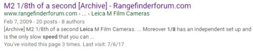

I did a search here but unfortunately it seems that the thread is deleted, even no cache on Google.
