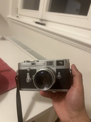

Hello Everyone, I bought my first ever Leica recently. An M3! I already had this Summicron 50 f2 picked up for cheap at an antique store last year. Unfortunately, the aperture mechanism is messed up and I will need to send it in for repairs. I heard from where I'm sending it that I am looking at a 4-month wait time. While I send this one in, are there any cheap recommendations for lenses I can use on this camera in the meantime? I've looked into adapting my exakta mount lenses to this but am not sure how accurate they will be. I've also heard that Voigtländer bessa mount lenses are interchangeable with Leica M. Thanks for the help!

You picked the wrong system if looking for cheap options, but most LTM/M39 lenses with a M adapter will work.
There’s a great variety of modern Voigtlander VM lenses that will work perfectly on your camera without adapters.
Forget about the Exakta mount.
There are so many options out there to use on an M system. Voigtlander lenses, like he said. Or get an Leica Thread mount adapter and buy a vintage Canon lens. You can find a 50 or 35 for less than $200. There's also Russian lenses (like the Industar just mentioned)
I have an LTM adapter on the way! ordered it before I even bought the camera. I've also been looking at a Color Skopar so I will consider it too
A 4 month wait suggests you are sending it back to Leica for servicing. This is not essential. These lenses are essentially more on the simple side to disassemble and repair. If the aperture problems are merely a matter of a jammed iris it is almost always a simple issue to fix for any experienced technician. Often it is due to oil from the helicoids gumming them up. But if forced the aperture leaves can become bent and displaced - a more problematic fix. The question is can you find a suitable lens technician in your locale. As others suggest any Voigtlander designed for an M camera is likely to be an excellent option depending on what your preferences are.
In the vintage lens department, a good and relatively inexpensive option is a black and chrome Canon 50m f1.8. As these are in Leica Thread Mount you will also need an LTM to M adapter which is only about $20. Just make sure you get one specifically for a 50mm lens (needed to bring up the correct camera frame-lines). I have found the after-market ones very satisfactory these days - well-made and much cheaper than the original Leica ones. As to the Canon lens, if you go down this route, just check it carefully as it is a vintage lens which can sometimes bring problems. In particular, haze can be an issue so make sure you are getting a clean one.
There is no way Leica would have a film camera back in 4 months. Currently 8-18 months is normal for ‘analogue models’.
