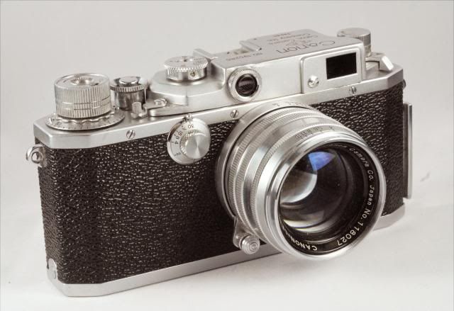

They weigh more because they're vastly superior cameras. I'm only being half tongue in cheek with that statement. But the P and the M series cameras have hugely improved viewfinder and rangefinder systems compared to the barnack leicas and their clones. This means they weigh more. But better viewfinders are more important to taking good photos than weight is (well actually a heavier camera is generally also a steadier camera, so that's not a downside either).
Of course they weight more but when I compare Barnacks with Canons I mean the Barnack styled Canons from the 50's.
They look nearly identical.
Comparing apples and apples, the later bottom-loading Canons, such as the IVSB are of considerably heavier construction that the Barnacks. I have a very nice Canon IVSB-2, which I think is by far the best built and most robust bottom loading 35mm camera ever.
The combined VF/RF with three magnifications was far beyond anything that ever appeared on the Barnacks as well. While the Canon P seems to be the collectors' choice, the earlier ones are quite undervalued, and usually a bargain when they appear for sale.

For weights, though, here are a few, body only:
Canon IVSB-2 535 gm
Leica II 420 gm
Leica IIIf (with ST) 430 gm
Leica M3 600 gm
FED-1 435 gm
Late model FED-2 520 gm
Zorki 6 565 gm
Panasonic GS-1 365 gm
Nikon D700 1110 gm
Cheers,
Dez

Personally, I'd give the Canon IVSB and Niccas a good look. They have a lot going for them including better reliability, better fit and finish, better viewfinders, better shutter "sound" (since that is one of the OPs criteria), on, and on....
I would not give up all those important things to save 50 grams of weight on a 70 year old Zorki. Especially considering a large Starbucks coffee weighs 473 grams, your wallet weighs 100 grams, the change in your pocket and cell phone weighs....
I just can't understand complaints about carrying basically micro cameras around, when a DSLR weighs as much and is 3 times larger, and no one every complained about them.
Cheers,
Dez
Agree with this. My IVSB2 feels distinctly heavier than my IIIc. The combined vf /rf in the Canon, with adjustable magnification, makes it especially good for fine focusing.
