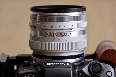

Hey guys,
I have adapted some lens from Yashica Lynx14 to canon M (18mm flange distance) and I had to cut some the back part to be able introduce home made adapter and to focus at infinity. Now the rear group is very close to the sensor. Do you need 28.8mm for LTM mount and that means you can use this lens only for macro?
