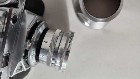

I think that there are three versions of the lens, each a bit different. This is my copy, the thread size near the name ring is 44mm.
I think that my copy is the last version, with the knurled ring at the front of the lens barrel that accepts 49mm Voigtlander screw on filters, as seen in the third pic. My lens will also accepts a 47mm slip-on filter. I also think that finding a suitable clamp-on filter ring is the way to go.

I found this thread after my Prominent purchase and revisiting the Nokton 50/1.5. I have a 47mm Voigtlander slip on UV filter and a 310/49 lens hood from the past. Unfortunately, the lens hood does not mount on the 47mm Filter. This is now where I purchased a vintage 331/49 Voigtlander adapter ring after reading somewhere it was designed to turn a 47mm filter into a 49mm filter. For the life of me I have tried every conceivable combination to find how this adapter or stepping ring is supposed to work, but still haven't found the answer. It threads over the knurled portion of the Nokton or also the Dynaron 100/4.5 without any filter, but that still doesn't achieve anything. A 47mm slip on filter will fit inside the front portion of the ring but doesn't have any threading to hold it in place, so that doesn't work. And the 310/49 lens hood does not mount inside the ring either.thumbnail_IMG_2938.jpgthumbnail_IMG_2939.jpgthumbnail_IMG_2940.jpgthumbnail_IMG_2941.jpg
My only assumption is this 331/49 ring was designed for some other usage, and the info I found was either erroneous or it was for any earlier Nokton version, with no threads? If anyone has ever seen or has this stepping ring, what to hell is it for???
My solution now is to purchase a Voigtlander 49mm UV filter which will mount the 310/49 lens hood. I know that works as I have a 49mm G1 filter.
I hate to bog down the website with such esoterica, but I'm hoping in this august group, someone might know the answer of have one of these original Voigtlander rings, which I am finding quite useless!

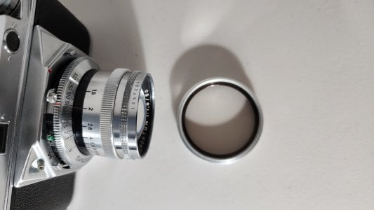

Well I believe I have solved the puzzle of this mystery ring 331/49. Looking through a manual for the first series of Prominents, I came across this reference to this adapter ring. I then tried a Focar A 47mm filter and snapped it into the ring and it was quite secure. I guess the tabs on the 47mm UV filter I had were not bent out quite enough to hold it securely in place when I tried this previously, but after altering them a bit, it does fit into the adapter ring. The real mystery is why bother? The 47 mm slip on works just fine and by putting this filter into the adapter ring, you now have a 49mm screw on filter to go over the Nokton lens mount.thumbnail_IMG_2942.jpgthumbnail_IMG_2943.jpg Unfortunately, the 310/49 Lens shade still does not mount onto the 47 mm filter front, which was my original intention....
