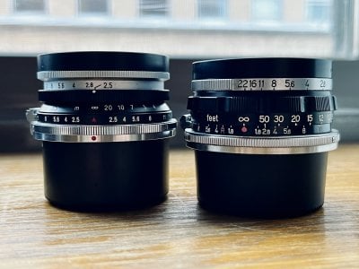

The 3.5cm f/1.8 has two threads: an internal 43mm thread for filters, and an external 48mm thread for the hood. Actually, the hood that came with your Voigtlander 35mm f/2.5 S-mount can be used for modeling the base, as it is also a perfect fit for the 48mm thread of the 3.5cm (see below). The Voigtlander 21, 25, 28, and 35 S-mount lenses share the same 43/48 threads with the 3.5cm f/1.8, I guess Cosina was inspired by it.
If you make a prototype I'm happy to print and test it! (I don't have the original hood, otherwise I would share the dimensions or try to model it myself)IMG_7215.jpg

I need to get a new battery for my calipers. I'll take measurements this evening and send them to you. I happen to have a Voigtlander 35mm f2.5 as well, and just confirmed that the hood for the Nikon 3.5 f1.8 does indeed fit very nicely into the outer threads on the Voigtlander (never tried that before!).

I hope these make sense:
Note that the the threads on the original hood are a spring mechanism that you squeeze to fit into the threads on the lens, and are a separate piece from the rest of the lens. That's what accounts for the discrepancy between the inner diameter of the small end of the hood (~52mm) vs the 48mm thread diameter.
