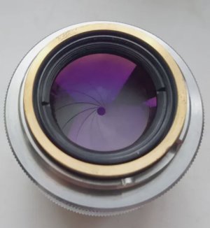

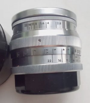

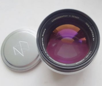

New Jupiter 3+ 50/1.5 wide open, minimum focus.
Great new all brass Sonnar; the Zeiss/Cosina C Sonnar ZM has wobble due the Teflon roller pins usury; as well as Skyllaney said
New Jupiter 3+ 50/1.5​
No plastic or Teflon inside.
Brass & glass only.
Small, compact & solid.
Built as well as should be; just as upon a time.
Coating right as Leitz lenses as upon a time.
13 rounded blades diaphragm.
27.5 inches minimum focus.
Aperture f/1.5 - f/22.
Filter thread 40.5mm.
Original Sonnar scheme elements/groups 7/3; no modified like Zeiss/Cosina Sonnar C ZM 50/1.5

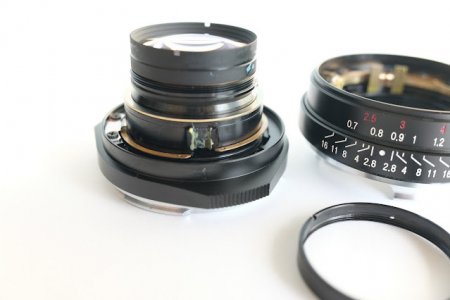

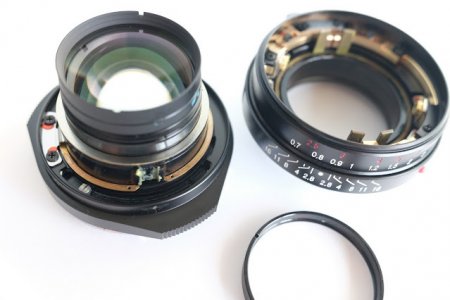

The Zeiss/Cosina 50/1.5 Sonnar C ZM has:
Elements/Groups 6/4.
35.4 inches minimum focus
10 no rounded blades diaphragm;
Teflon roller pins focusing gear
Aperture f/1.5 - f/16;
Filter thread 46mm

The price of the Jupiter 3+ may seem high, but you have to consider it a hand-built object made only of brass and glass. If you think it is more convenient to buy Zeiss/Cosina, now out of production, or Voigtlander/Cosina, know that in these there is plenty of plastic and glue inside them. Just for instance: Voigtlander 35mm F1.4 II Nokton Classic
