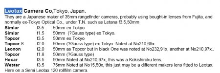

The Leotax cameras are not rare - value in good working order for the more common models is around $ 250.
Attached are some notes from the Lens Collectors Vade Mecum on their lenses ( http://members.aol.com/dcolucci/sell.htm )
