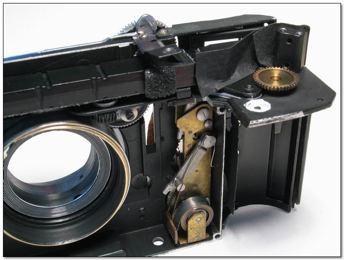

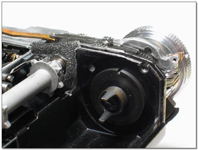

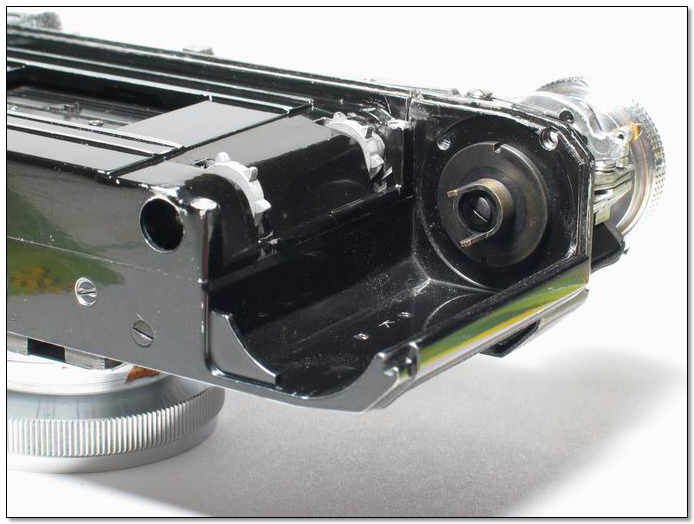

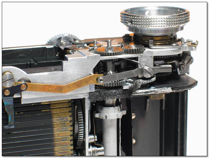

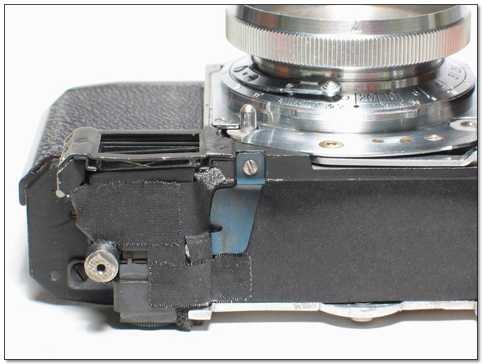

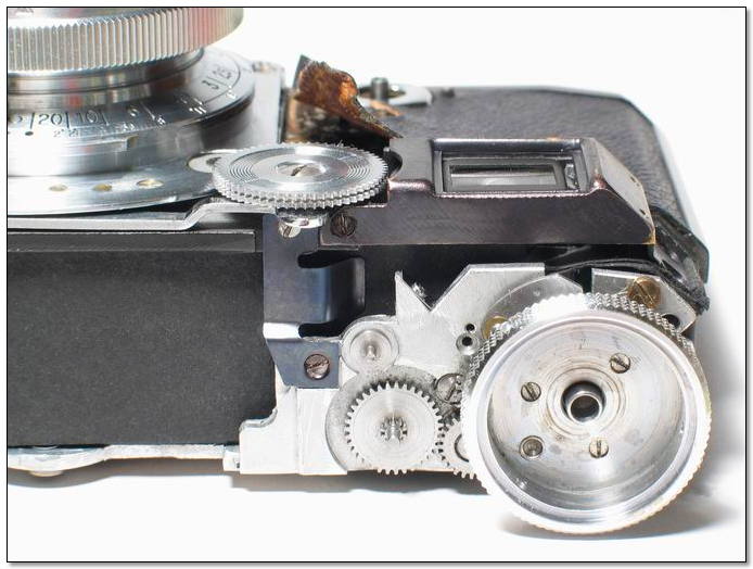

See pics below, from my own Contax II DIY restoration sessions - using some 3mm acetate ribbon bought from my local craft store, which worked just fine, as Rick wrote.
The light baffles at the top of the sprocket-spindle seem to be a solution to a problem Zeiss Ikon didn't originally know they had. I haven't seen enough cameras to be certain, but in my rather limited experience, it looks as though the earliest cameras, up to 'B' serials, may have had nothing at all. 'C' serials had the D-washer you describe, and then at some point they added a rather complicated and fragile baffle I've pictured below. I think this normally fitted below the D-washer, but I've seen it above as well. The flat piece to the right (sort-of L-shaped) slides in above the body casting, though my picture of it in place is not very clear. Most Kievs have this baffle as well, but I think some may just have had a larger D-washer. The baffle I've photographed (in a 'G' serial Contax), appears to made of aluminium but I've just repaired one from a Kiev that was made of brass.
I'm not sure where the light leak comes from that these baffles are meant to prevent, but I rather suspect you could live without both and never notice a problem.
As Highway 61 has said, you are dead right about the way to fit the back-casting without damaging the D-washer. They are always badly mutilated. It is very easy to forget to align them properly while assembling.
Besides refitting the D washer as described, all I did with my Contax was reattach the one corner of the (pretty minimal) black paper light baffle that sits on top the left-hand end of the viewfinder prism. This seems to have done the trick, because there's no light leak visible in any test frames.
I think it became more of an issue with late models Kievs, where the close fit between body and shutter castings became a yawning gap!
There are a great variety of light-sealing measures on these cameras. It would be nice to know what they are all for! I just try to replace them as I found them and hope for the best.
Contax always have the paper you mentioned at the left-hand end of the prism. Kievs never have this, but they do have one at the other end covering the gap between the shutter chassis and the prism. Contax never have this.
As well as the long twine running along where the back fits, most cameras also have a short piece fixed to the top-casting. Sometimes this is at the mechanism end, sometimes at the eyepiece end. All very confusing!
The stuff you learn on this forum! There's no sign of that wonderfully complicated pressed tin/brass baffle in either of my Kiev 4s, Grytpype (no Thynn?), although they would both have benefitted from one (light leak visible image bottom right/sprocket corner of frame).
I wonder if the thing was supplied as some kind of service fix, rather than a standard factory fit?
