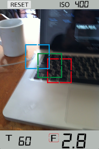

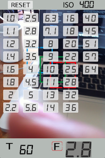

LightMeter app was acting up on iPhone 4 so I started using this "Light Meter" app. http://itunes.apple.com/us/app/fancy-light-meter/id367216839?mt=8
The controls are on the live-view screen so you don't have to go back and forth between dial screen and camera view. It's not a crazy fantastic execution, but it works fine when I need it. And I've jailbroken my iPhone 4 so I can pull up this app by a long-hold of sleep button (or whatever you like). ;)
