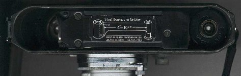

Have you cut a longer film leader? That will allow the film cassette to seat more easily. At one time, all 35mm film came with the correct length leader to fit Leica and Canon bottom loaders. Then the mfr's conspired to change to a shorter leader...and the rest is history.
I actually cut it long enough to roll back into the canister and then load the film with only the fully cut leader showing. I then wind on an extra frame to make sure I don't start shooting too early. I loose a frame or two, but that is ok in my eye.
