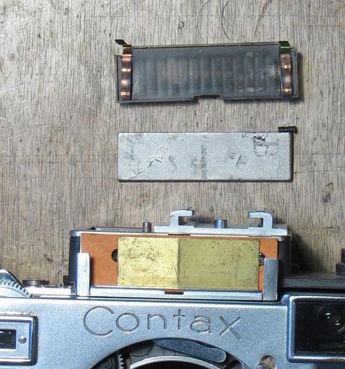

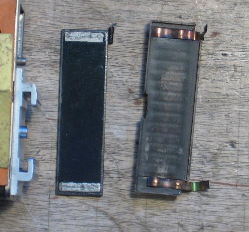

I've photoed the parts from a scrap camera.
Both the contact tabs visible from above are the 'earth' connection. They are clamped to the body, the left by the front-flap screws, the right by thr meter cover (though the one in my photo was short, and I would not have needed to remove the meter cover).
The cell and its lens slide out upwards. There are two metallised strips on the front of the cell that contact the earth tabs, and the other connection is made between the metallised back of the cell, and a spring plate attached to the body. It all falls apart so you can polish the connections.
Good luck!

Thank you all for your comments, the pictures were especially helpful. I was successful in getting the meter to work again -- the problem actually turned out to be the connection between the ISO adjustment knob and the meter.
I did discover that the meter on my camera has definitely been overhauled at some point: the selenium cell is stamped with a post-production 1968 date, and has soldered connections (front and back). The earth clips actually don't seem to be doing any real work at all, in my case.
