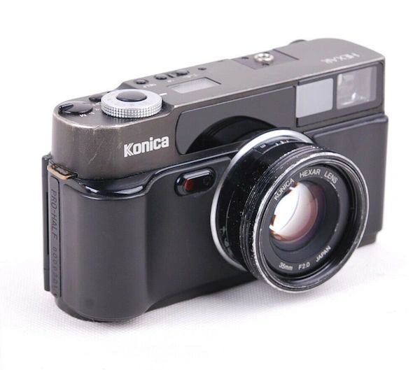

Konica RF PRO-HALF is ultra rare; only 50 were made! Logo is on side, below neck strap lug.
