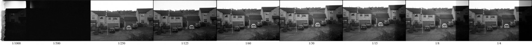

Hi, I bought an M2 a little while ago and the first roll i put through it was spot on, but since then it's become a little sporadic.
The second roll was mostly ok, but with an occasional diffuse dark patch to the left of the image. I didn't record the exposures so can't identify any pattern. However, I recently made a test strip (identical exposures, cycling through shutterspeed/aperture combinations) which showed a sharper dark band to the right.
(Examples attached)
Now, has anyone encountered this problem before? I'm assuming that there's curtain lag somewhere but is it likely to be as simple a fix as cleaning and lubricating and could I do it myself?

I have a similar problem with M2, though not with such a dramatic effect. at higher speeds I sometimes get a shot similar to yours, but without the band on the left. and at 1/15th I often get a stripe on the right side. have you tested your slow speeds? I can see how the first curtain stops right before finish and closes when the 2 curtain slides over, creating a stripe on the right side of the image.
I havent brought mine for repair yet.

Not sure about bounce, this more like capping to me. Either way the shutter needs a CLA. CRR is good but you will need to phone and book it in. At least with capping, you might get a short term improvement by exercising the shutter as Noel suggests.
