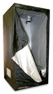

Hi, I would like to set up a darkroom in the house. I have all the gear but not the actual darkroom.
I have looked at the nova darkroom tent but the price put me off. Then I came accross these cheaper darkroom tents used to grow plants
Does anybody have any experience using this for photography. The model I was looking at is the same size as the nova tent.

They have a light tight ventilation hole at the top as you can see from the picture.

Great point, specially about the zip being on the outside. My wife is a costume maker so hopefully she can sort that out. I would also trow black fabric over so that would help.

I also got a reply from the company. This is what they said "hi,
these tents you can put 1000w high intensity light inside and the material does not leak light.as long as you keep the vents closed then no light will get in.im confident you can use this item for the application of photography."
The price is £89 (130US$?) which is very different from the Nova option (£529)
I think I will go for it. If it does not work I can alway grow cannabis on it :)

:) hey if you put that tent up but inside out from the picture shown the zips would be on the inside , plus it would look like some kind of space ship :D
A silver room is going to make a bad darkroom--printing contrast is going to suffer with all that light bouncing around. You would want to turn it insideout.
The Nova tent comes with a ventilator fan, guaranteed light trapping, and the kind of build quality that allows you to go in and out indefinitely. We bought one around 20 years ago. It has been our only darkroom on several occasions, for months and even (when we first got it) years at a time. Expensive, yes, but in our experience, well worth it.
And it's roomier than you might expect. These things were quite often used for demonstrations at trade shows, and not just by Nova, in the days when darkroom was more important.
