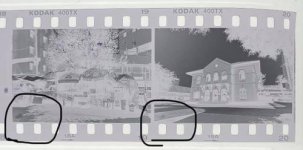

My first roll from the newly acquired Leica M3 many shots, not all, got a mark at the same position close to the corner. This happened with 21mm, 35mm, and also 50mm. Is this from a faulty camera or from my mistake in developing?

Best guess is a light leak in camera.
Possibilities are shutter holes, back door, strap lugs, or top deck not sealed.

Light leak. Since it’s in the lower left of the frame, the light source is actually at the upper right.
My suggestion is to wind the shutter, remove the lens and bottom plate, flip open the rear door, and while aiming the camera at the bright sky or other broad bright light source, look for the leak. If you don’t see it, release the shutter and look again. If you still can’t find it, perhaps the leak is coming from a very small hole where the rangefinding mechanism resides.
Get into your darkroom with a small flashlight, if it’s a hole in the curtain you will easily find it.

I went to the shop I bought this M3 and he guess it was the shutter curtain and it may take few weeks to get the parts and fix it.
