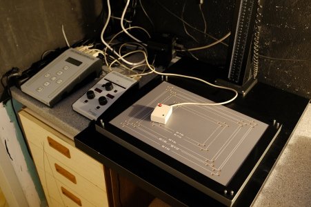

Right on Harry. The Heiland Splitgrade Controller unit can be used with their enlarger V.C. light source, or on manual mode with two (high and low contrast) Multigrade filters, or a dichroic enlarger light source. No more test strips, just the probe to measure high/low density areas of your negative. The unit will then suggest Y and M (or you can use green and blue) filter exposure times which you can manually fine tune as necessary.

Hey, that is a misunderstanding. It´s super easy to dodge and burn with the Heiland machine. I can do it as much as I want, the system encourages me to do it, because in no time I can program additional phases of exposure with any time and gradation I find necessary.
I don´t know where this misunderstanding comes from.
