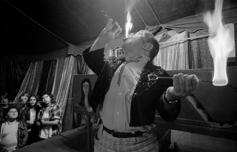

I often print using multiple filters. Here are two examples of prints from negs that are your worst nightmare. The fire in both cases had to be printed with a 0 filter at 7-8 times the base exposure. There’s a huge amount of dodging as well.

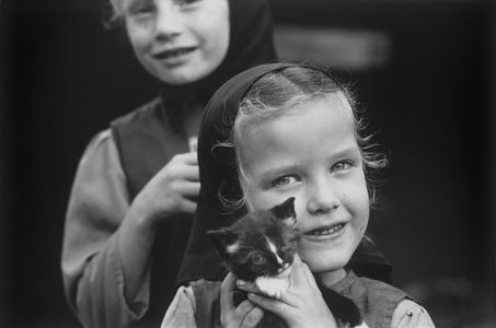

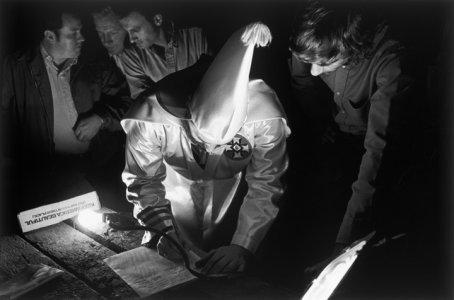

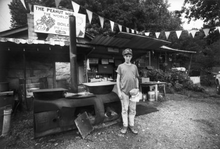

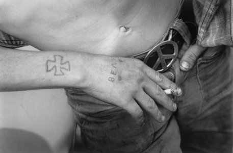

Not only are these great prints, but also amazing photographs!I often print using multiple filters. Here are two examples of prints from negs that are your worst nightmare. The fire in both cases had to be printed with a 0 filter at 7-8 times the base exposure. There’s a huge amount of dodging as well.
x-ray
There’s no shortcut to bringing life to a print. Give a negative to ten good printers and you’ll have ten different interpretations. You might be able to straight print a negative and get a technically good print but it’s the dodging and burning where the brilliance of the print is brought out. How a negative is printed has a lot to do with the mood of that image.Not only are these great prints, but also amazing photographs!
Every one of these images has extensive dodging and burning that brings the subject forward and helps create a mood.

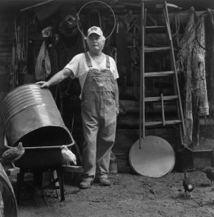

Other than subject, one of the differences between Erik’s prints and mine is, Erik prints are printed for tone in the highest value which brings them just below white and tone just above black in the lowest. He lets all the other values fall where they may. Those values become the most important things in the print.
I print for the subject and adjust my high and low values around my subject. I use dodging and burning to do that because it’s rare that that occurs naturally.
Go back in the samples posted in this thread and notice how a window in the shot overpowers the real subject or the subject is buried in deep shadow. Erik doesn’t dodge and burn. That’s Erik’s interpretation but I think he’s doing an injustice to his images.
