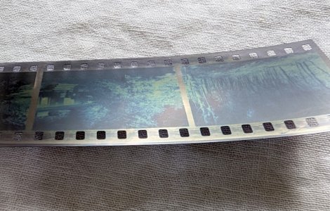

Was it something like this ??
I don't know what this is.

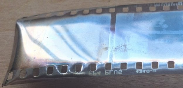

I found this strip of FP4+ lost between old documents.
I used this film more than 10 years ago and I cannot recall the development process I used then. I kept it apart intending to find the original roll - when I have time and patience. If your film looks like this, I look forward for an explanation..
Regards
Joao

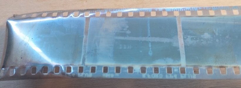

Unsufficient fixing seems to be involved as the metalic sheen is also visible north and south of the perforation where fixing should have removed any silver-halide.
