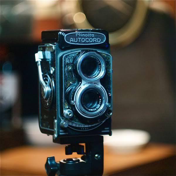

I've been working on this Autocord. It had a frozen shutter, locked up self timer and a completely jammed
shutter button, not to mention a stiff focus.
All that has been repaired. I was very impressed by the construction of this camera. Quite nice.
However, I just found that the rear lens group inner element had been badly scratched/gouged by someone. 😡 I may not have bothered spending all that time on the camera if I had thought to look since the front lens group looked so nice... argh!
Anyway, on the off chance, I thought I'd ask if anyone around here might have a rear lens group for one of these TLR's... that I might purchase? Pretty please? Anyone with a dead Autocord? Just that little old rear lens group?
During...😱
After...🙂

I just received a very rapid and cordial email response from Karl, the camera repair technician, if anyone is interested. It says,
"Hi Jack, you will need both lens groups because they are matched at the factory and lens cells/groups are not interchangeable. My experience in replacing only a rear lens group has been the focal length of the new lens (old front group and new rear group) increases 83-87mm, typically way beyond what the focus rack can operate to. You also need to make sure that the cell spacing (distance front and rear groups are spaced within the shutter is adequate for sharp focus. This type of work requires a good collimator.
Best recommendation is to locate a parts camera.
regards, Carl."
