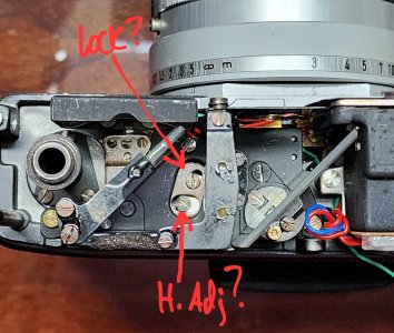

I got a great copy of an original 7s last summer, but forgot a strap one day and dropped it. I noticed the images I shot after that were soft. I have had the thing apart twice trying to bring infinity and close focus into agreement, but when I get one dialed in, the other is off. I don't know if I'm missing something, or adjusting the wrong components, it's all just trial and error.
I have seen lots and lots of posts asking about adjusting the 7s, but no one has posted a simple photo with the screws labeled, or if they are, they're for a different Minolta RF.
Does anyone have something like this? I'd hate to scrap such a great camera.

Is the vertical alignment off? If it is- the vertical alignment must be set first, before horizontal alignment can be done.
The mirror can be "tilted" using the set screws. I've done this "painful" adjustment on a Minolta Electro, but the mechanism is a little different from the HM-9 and HM-7s. If you've popped the top, posting some images might help.
As far as I know- once the Vertical alignment is good, set the horizontal for Infinity- focus should be good across range. If it is not- soudns like something is bent or broken.
The screw in the oblong slot in the center appears to be the horiz. adjustment and the one above is the lock screw?
Yes, that is the horiz adjustment as far as I can tell. I dialed it in this morning, but when I reassembled the camera, it was a hair off again, but I shot a test roll anyway. Vertical is good, so I didn't bother. I'm not sure if there's just one adjustment for near/far, or if there's a separate screw for each.

I received a Hi-matic 7s today and had to align the range finder vertically, bringing me to this post. From my testing, it appears that the screws behind the mirror outlined in green are the ones used to align the mirror vertically. The left (brass) one is actually a nut, so can easily fall off, and appears to be more of a lock nut, and the one on the right seems to have more of an impact on actual vertical alignment.
By adjusting these I was able to fix the vertical alignment issues on my 7s and get it a bit easier to focus. Now I just have to figure out why the frame counter didn't reset after loading my test roll of film. 🤔 Screenshot_20230305_110014_Gallery~2.jpg
I finally got enough time to disassemble the Minolta 7s. I can confirm the above diagram. I also managed to fix the 7s I bought for $10, the Aperture ring had become idslodged from the mechanism and the Tab for taking the camera off Automatic was jammed, filter ring dented, VF dirty- etc. Had a great time working on it, photographed everything.

SO: I opened up my Hi-Matic 9 to verify the Rangefinder mechanism is identical.
It is.
