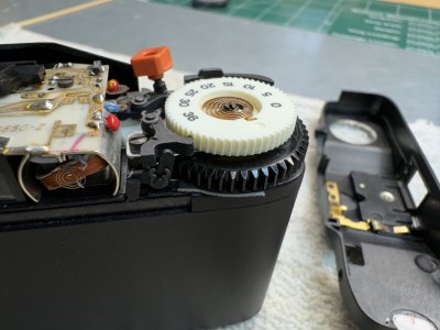

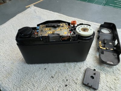

Here it is, as far as I was able to disassemble. Getting to the crank seems a but daunting.
Maybe I’ll just file off the sharp bits

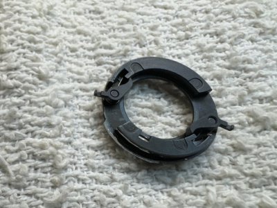

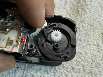

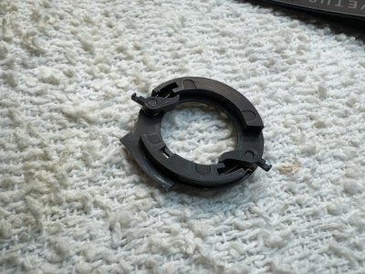

Well I managed to get to the disc
It is part of a mechanism that moves the counter and not simply a crank lever.
So I had to keep it, but managed to file it down with a rotary tool grinder.
Surprisingly, it is made of metal. It always seemed it was, but when the lever snapped off, I thought it must have been plastic.
How the lever broke instead of the film sprocket holes ripping is a mystery.
Now to put it back together and hope it still runs. Lots of fiddly hairpin wires to get right.

I have it put back together.
Winds and fires as many as you like, unless film is loaded, in which case it goes about 5-7 exposures before it gets impossible to move.
This is what led to the broken crank to begin with, so I don’t think it’s an issue with the reassembly.
Really frustrating and i’m not sure how to troubleshoot it.

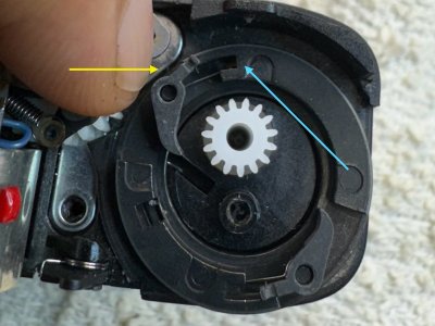

Reassembling was tedious.
Best I can offer you regarding the hairpin springs is to pay attention to the orientation as marked with the arrows in this picture.
