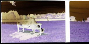

OK, I'm confused. Easily done, I know, but...
I've just got three rolls of film back from the lab, and each one has an intermittent light leak on it. I can't find a rhyme or reason to it - the biggest leak is on a pic taken on a bright sunny day, but the next biggest are from ones taken on an overcast day. That's confusing.
What has got me really confused, though, is that the leak on the negs lines up with a piece of felt behind the pressure plate around the 6x9 window on the film door. It's even got furry edges that really look like the edge of the felt. But it's white - so it's light coming from in front of the film! I've attached a scan and a close-up for your delectation.
I can understand that I might have a leak from the window, but I'm thoroughly bemused that it's coming from the front of the film, not the back. I can't see anything that it might reflect off. Incidentally, it's Fuji Reala 100, and is a nice orange-brown.
I've gone round my bellows with a torch, and again with a flashgun, and can't see anything so I don't think it's those, and it's certainly not from a loosely rolled film as the leaks are horizontal rather than vertical. Has anyone any bright ideas? I'm very fond of this camera, and seem to take better photos with it - probably because it slows me right down, and I only have eight on a roll!

Thanks for the thoughts - I want to beat this, as the Moskva is my holiday hillwalking camera!
No, it's not the first roll - I've put at least two or three through a year, and I've not seen that hair before (unless you mean to the left of the frame - that's a boat's mast).
The leak doesn't go past the edge of the exposed area on the side, and the numbers are fine. On the film with the pics shown, the worst one, the leak actually stops just before the edge at the side, and extends slightly over the top edge of the frame. I've attached a scan, but I doubt if it will tell you much as I don't have a tranny scanner or a lightbox handy. The mother-out-law does, so I should be able to get a better scan done, and the digi battery fell over as I took the pic of the back of the camera... So I'm waiting for the battery to charge!
If you look closely at the light area to the lower left hand edge, and the left-hand bottom edge you'll see what I mean. On the other two films, it goes right to the edge.
So the light is probably coming from in front of the film gate , I wonder if the stop before the edge and the slight overlap means that it's happening when I wind on, when the film is a little more flexed? The only place I can see where it MIGHT reflect, IF the light is coming from the back, is off the roller or off the spring to hold the paper tight on the roll, both of which are silver.
Anyway, we've not got all the bits of the jigsaw yet, and I haven't been hit with the blindingly obvious stick, so I'll add more when I get the decent scan and the battery charged.

OK, Cameras. Given the complexity of the light path, I fear you are right about the bellows. Will have to do some thinking and try to get in there somehow. Here's that pic of the back anyway - should be hitting the M-o-L's tomorrow. Incidentally, no your eyes do not deceive you! Yes, I thought that was the hair you meant - haven't seen it before.

Here's the scan of the neg - plus a bit from the next neg, so that you can see it's intermittent.
Still thinking about this one. No sign of a hole yet, might see if I can find a dentist's mirror.
Adrian

Chippy,
Thinking about it, I reckon that in both cases where the leak is worst I had it open for a little while while I worked out my picture. Usually I compose with only the viewfinder open, so a small hole behind the front door would be masked. If I wound on with the bellows extended, that would at least partly explain why the leak doesn't quite match the film gate.
Bother - now I have to work out how I'm going to find and fix it...
Adrian

Have you noticed that the light leak is a different shape in each of the two photos? This is probably a lab accident.
It's a clip from the same photo, and I forgot to rotate it...
It's in the same place on every affected shot, and a similar shape, so much as I'd love to think it's the lab I think it's the bellows. Drat!
