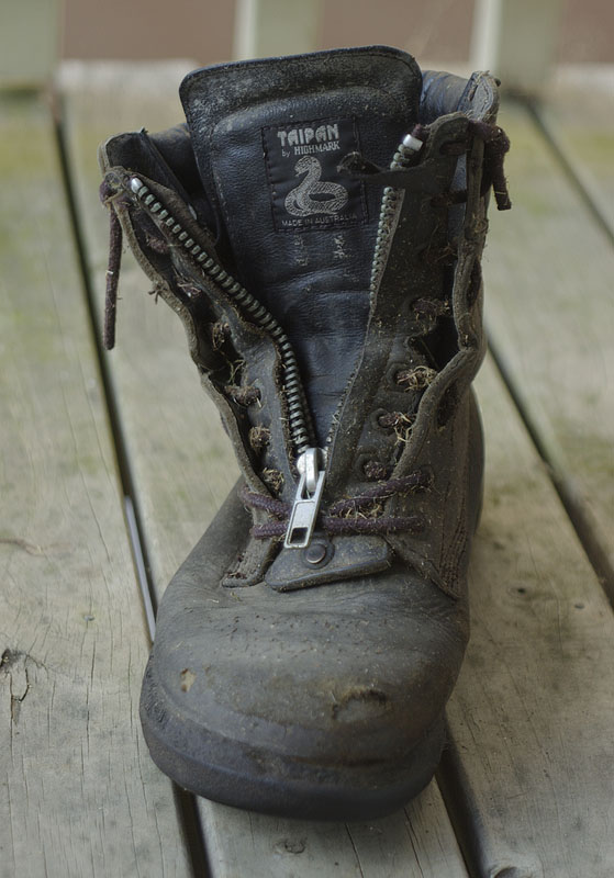

Relubed and on the camera. Tested it today against my Nokton 40mm. Nowhere near the quality of manufacture or operation of focus etc. but the images compare well. At least of my old boot 🙂
Images have been resized and given same amount of unsharp mask.
Focus point is zip handle.
I61 @ 2.8 wide open - 200 iso
Nokton 40 @ 2.8 - 200 iso

Hi John,
I like this kind of comparison. Gut impression prefers the Nokton image, but the Industar isn't far behind. The nokton image seems a little more 3 dimensional somehow. Anyway thanks for the comparo. and you might want to think about new boots!
Steve
As Matt said, the only real noticeable difference is that the I-61 has a little bit lesser contrast. At web-resolution sharpness comparisons are pretty moot.

radiocemetery said:
Hi John,
Steve
New boots? Never 🙂 Once I finish fighting fires with them they become the comfy lawn mowing boots.
There are some differences. Maybe the 3D feel comes from 40 vs 50mm after a little cropping?
Cheers,
John
I first tried to do a 100%, no sharpen comparison that still looked ok within the 900 pixel limit. But it didn't seem to give the overall impression of the lens that this does.
I do feel that web-resolution sharpness does have its place as long as both images are resized and sharpened exactly the same. In other words if one image is softer than the other before, it will still be after the changes as long as the sharpening is not over done.
In this case the main variables are,
1. My focussing
2. A change in light between lens changes causing the camera AE to adjust shutter speed (maybe I should have shot manual?)
3. Slightly different resolutions after crop but before resize due to 40 vs 50 view
Cheers,
John
