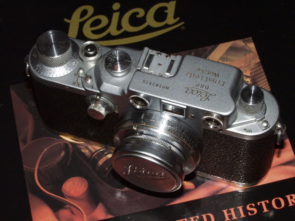

Hello all
I was after an early IIIc for some time now but when ever I saw one it was quite expensive because the "selling" argument always seems to be "military camera of WWII years".
Now I finally found one for a good price and bought it...
...and after a night shift it now looks like that.

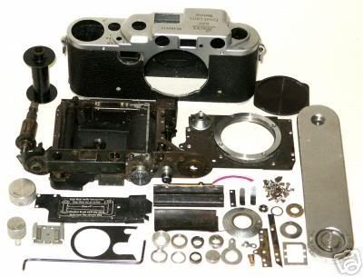

I am still missing some parts on the back and some screws are the wrong ones but will get all that fixed next week with the help of a collector here in Munich. I also have a 1940 Summitar spotted that I will most likely get for it.
cheers
Uwe

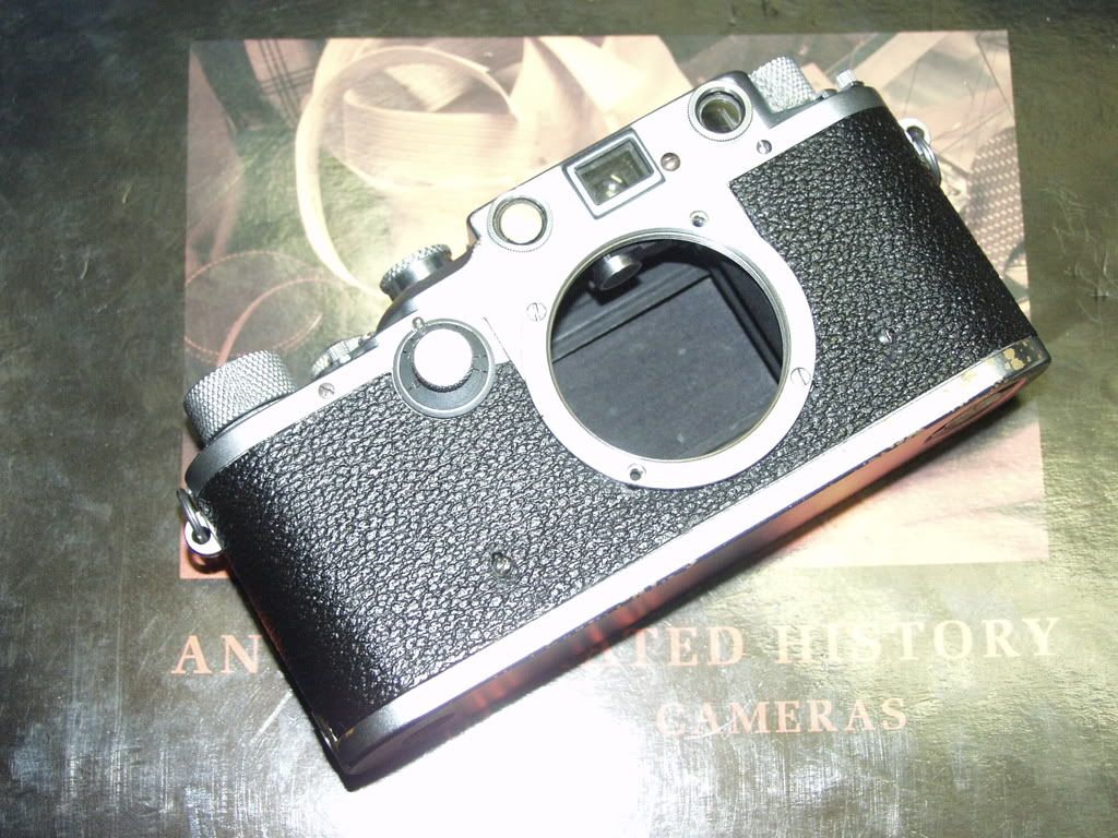

Congratulations! Don't be surprised if you need to have someone "collimate" the camera, determining how much shimming the lens mount needs to be the correct 28.80mm from the film. (Unless you have your own auto-collimator.)
The screwmount Leicas are fun to work on.
Of course, now is when you'll discover the pinholes in the shutter curtains...

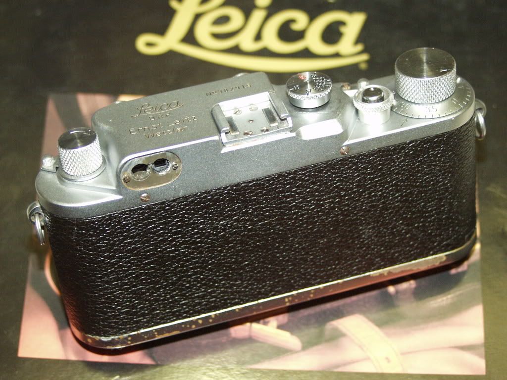

What I just spotted by going through some posts here is, that is has B instead of Z on the speed dial nob! Is this ok for that year? The bottom lid is engraved in German and English...close-zu, open-auf
thanks
Uwe
With that chrome pitting just only on the bottom lid, could it be that the lid is not original to the camera?
That chrome pitting is typical of 1947-50 Leicas.
Yes, that bottom is for sure 1949/50 era and the B setting is WRONG for a 1942/43 era camera -
B setting came around camera #392500 or late 1945/early 1946 whichever came first
The post May 1945 Leitz records are a bit crazy, lot`s of old and new numbers being juggled around
One thing`s for sure your camera is a late 1942/43 model and one of the first with the locking button on the slow speed dial,
not a rare camera, but it is a wartime era Leica and was more than likely used in Civilian serivce during the war
Tom
If the parts (crate, front cover, lens mount) are matched it won't need shimming since these parts have been properly fitted to have proper register between lens mount and film plane..

I was really lucky with this one, since it was in bits it was only 155 pounds and the shipping from the UK was cheap as well. Also the current $ weakness seams to affect the pound as well😀so shopping in the UK is kind of cheap as well...
