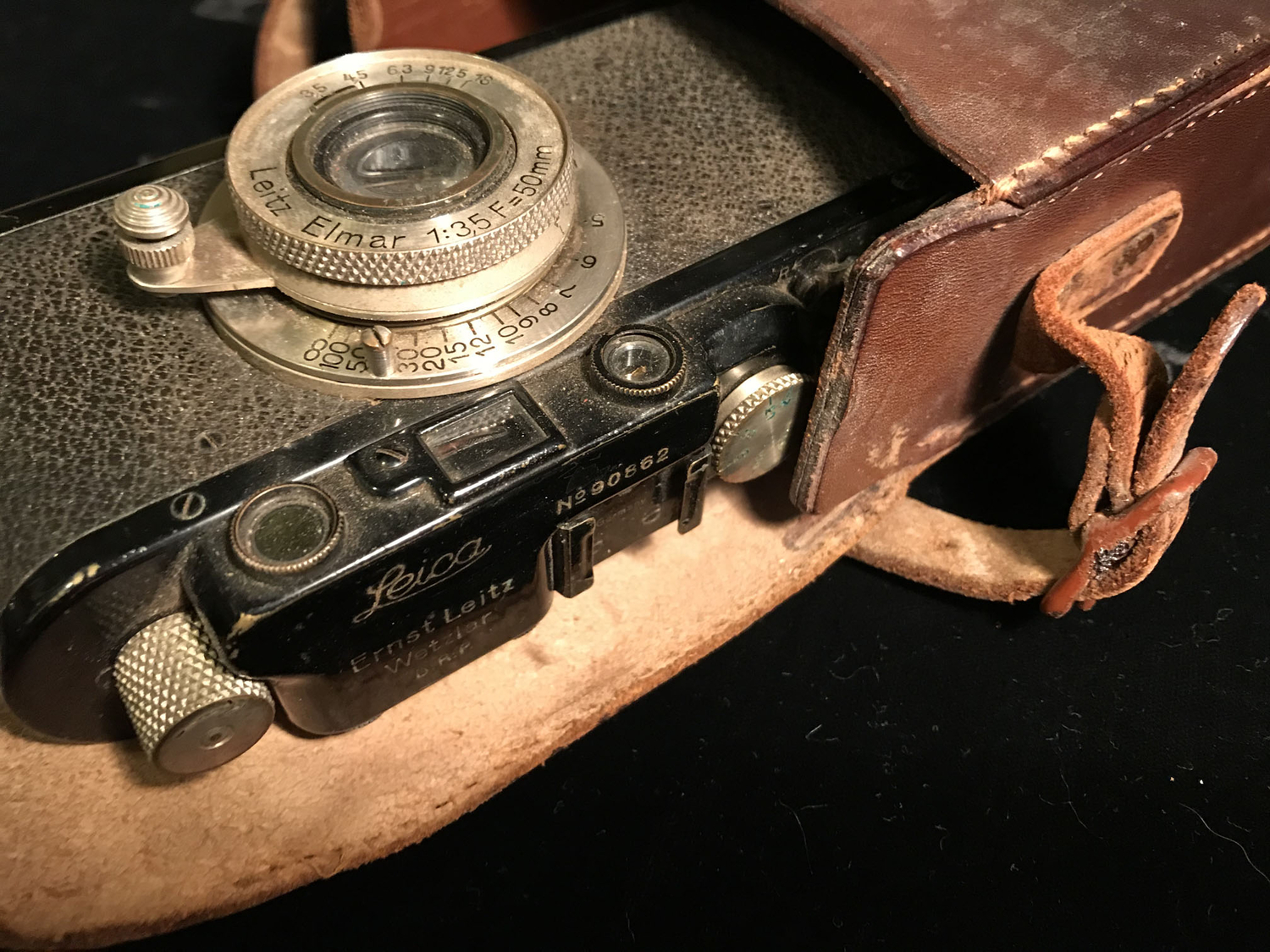

Look what I found!
Seems to have been unused since the 1980's. Shutter still fires very sluggishly and its dirty BUT I think a good CLA will wake it up just fine.

Nice! Antique store find? Looks like its been sitting on a shelf for a decade or more.

Sweet 5-digit Leica II

Even if it needs a shutter-tune by an expert like my 1933 III did, it is still a bargain and a lovely old camera. It looks like it is extremely well-kept and has had relatively low use.

Nice find. Too bad it has stupidly been kept in a leather case. The verdigris spots on the camera and lens and the milky stains on the leather turn the fungus alarm bell on.
The shutter release guard is missing but nowadays it's become easy to find some copycats of the original part (nickel finish).

The camera was in the case for a LONG time but I've seen (smelled) worse. Really just a couple of small green spots. Everything is stiff but functional:
While watching TV last night, I carefully went through my cleaning protocol for old cameras. It looks WAY better! Quite pretty, actually...
I will post another glamour shot or two
I have more to share about the story as well...
- Lens was difficult to unscrew (got it off though)
- Lens aperture is like molasses, focus is stiff, and it won't collapse or extend hardly at all
- BUT no fungus or obvious damage to the glass!
- Shutter fires at 1/60 but drags- I'm not going to risk damage by firing it further
- Viewfinder and rangefinder windows cleaned up great and the RF works accurately
- Rewind extends OK and spins
- A - R lever works
- Ordered a Nickel-Plated release collar from "Nobby-Sparrow"

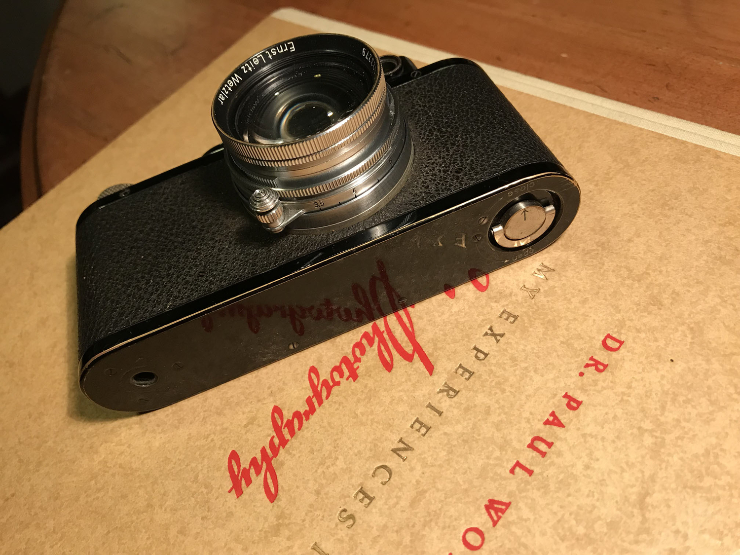

Here she is - all cleaned up - and sporting a Summitar I picked up this last summer!
Camera was "Once Upon a Time" used at a research lab at Univ. of Penn back in the 1930's until WWII

Congratulations on being the one to wake up this sleeping beauty!

Open/close and small tripod bush on base, 'Germany' on shoe...destined for export...

what a lovely find, a beauty

Congrats! Camera looks great!!
