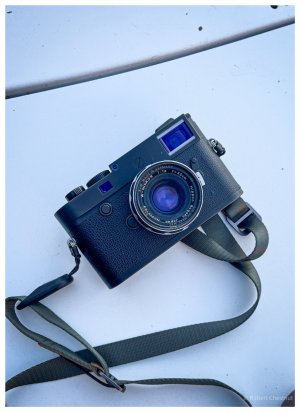

The lens works pretty well. I think I need to shim it a little to get focus 100% accurate. its pretty close as it is. It renders black and white like a dream on the m10 Monochrom! I am very impressed! I I like this lens way better than my steel rim reissue that I had. you get that leica style glow on hightlights but it seems controlled. the tones are pretty amazing too.

I have the one pictured in post 12. after owning it pretty much since that post I can say I love it. Just shot some photos at my cousins wedding. Its fun to zone focus. its fun wide open and its fun to use at f8 and 20,000-40,000 iso on the m10m like the photos below! has character wide open and it tames up stopped down and has sorta 35mm summicron v4 micro contrast stopped down. Not the sharpest lens I have ever used but certainly a great all around fast 35mm with some good character.
