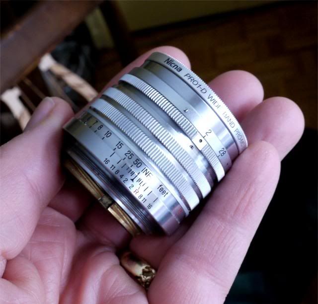

I have a Tanar H.C. 2.0/50mm LTM, which is a close copy of the Nikkor H.C. So close, I'm thinking it is simply rebranded...😕
My focusing index and aperture index do not line up, when the lens is set to 2.0, the focusing index mark is between 2.0 and 2.8.
I'm set on selling the lens but took it out today to test shoot it and it is kinda nice...🙄

I got one, and the difference is only a few "minutes": it is almost lined out. Also see this all chrome offer.
By the way mine is a "last" version, scale starts at 50-30 feet, has a chrome coated thread and slim/unribbed front ring; the older version starts with 50-25 ft, bronze thread, ribbed front retaining ring. So as far as I have seen there are at least two versions. Mine is sometimes called 'black belt'.
