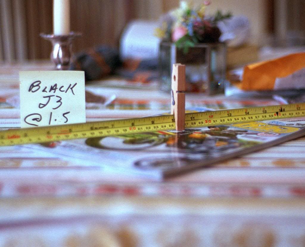

Having the lens front focus is rather unusual. How much is it off? I generally use something like this as a test bed:
The measuring tape is arranged at about 45 degrees to the camera, here testing a J3 at 1m distance. It back focuses by about an inch as expected. I may get around to changing the shims one day.
