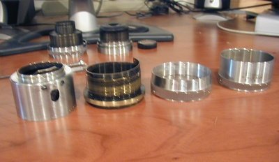

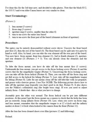

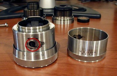

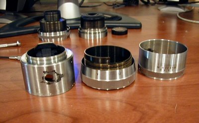

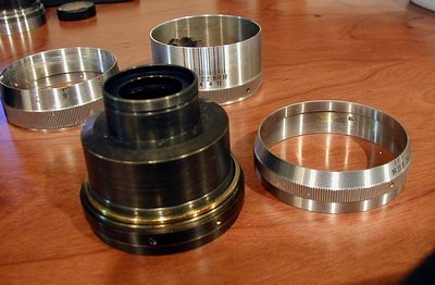

Daimon has posted fully illustrated how-to instructions in this thread, see page 2!

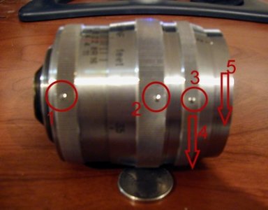

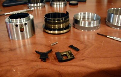

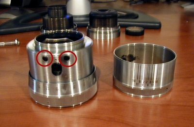

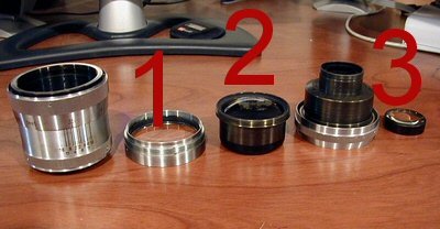

Could not remember when did I download these images, they are in my file. This one is Nikki’s 85mmf2 ltm, can be used as reference, it is similar to 105mm f2.5. I sued this as reference to CLA my two 105

To separate helicoids I actually need to remove part used for rangefinder coupling? Using those 2 screws on outside of the barrel? Looked inside the focusing unit from the other side and couldn't see any stop screws from the inside
This is a guess- and is based on working on the Komura lenses and some others.
Try removing the focus ring first- on other lenses I've worked on, that reveals the helical. ALSO- I learned with the Komura lenses to expose the threads, but do not separate them. Too hard to get back together. IF you can find the correct starting position again, sometimes the metal has malformed and will not start. LOTS of filing on a Komura in just the right places to get back together.
My memory maybe not correct, here is all I remembered.

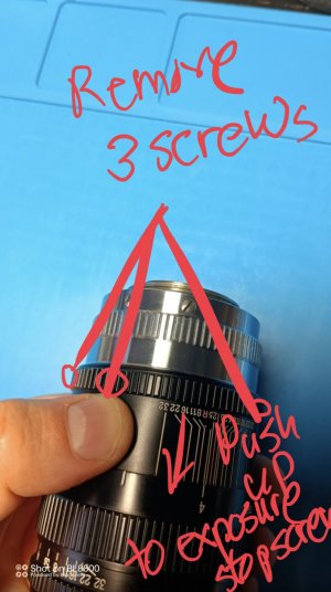

You do not need to remove the RF coupler, remove the tripod mount, move the focus to the nearest distance, there should be few screw hold the the black part that hold by your thum, move up to exposure a screw that prevent the focus helical move any further in the closest distance, remove the screw should be able to move the focus helical out, be careful, mark the place where two parts separated, so when you put back it should be in infinite position.
