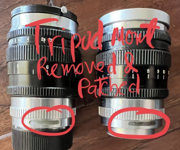

I find the tripod mount is useless and add weight, so I removed it and patched it. It is roughly the same size as Leica 90mmf2
