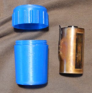

I had fun drawing and printing the containers for Nikon's reloadable film cassettes.
The container is not an exact copy of the original Nikon containers.
The Nikon containers have a three-start thread, mine only have a two-start thread.
So you have to turn my containers about four-fifths of a turn to open them, while the Nikon containers only need a one-third turn.
I hope you can live with that.
Attention!
The containers fit the Nikon film spools and also the Zenit film spools. (tested)
The containers do NOT fit Leica film spools (too short) and do NOT fit the normal 35mm / 135 film cartridges (diameter too small). (tested)
Unfortunately I didn't have any more film spools to try out.
You can find the files here
Happy printing.

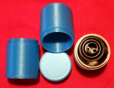

I have containers for all my spools. I made this one just for fun, because maybe someone has spools but no containers ;-)
I've now drawn one for the longer Leica spools and one for the normal 135mm film cartridges. I'll print them out tomorrow as a test, upload them to the database and link them here in the forum.
aaand the container for the ordinary 135 cartridges. With six different lids so you can feel without lookin which container ya grab in the darkness of yer bag.
The lids from the Nikon and from the Leica container fits also. The lids are interchangeable to fit yer personal preference ;-)
