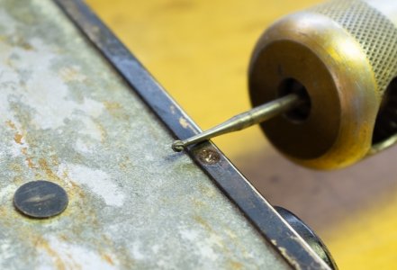

Get the goo off of those screw heads and take a look. Then you'll really know how good/bad they are. If they are really bad drill the heads off and extract the remains after you get it apart. A ball burr would be even better (Got Dremel?). If the part the steel threads are in is brass you can use acid to remove them, assuming they don't just turn out. I've used sulfuric acid from a car battery to do this. You only need the acid to loosen the remains, not necessarily to dissolve them away entirely.
I ran into a badly rusted screw head on the '30 Ia I'm in the middle of now. The ball burr cut away the remains of the head to the point I could get the top off the shell but I still need to remove the remains of the screw.
