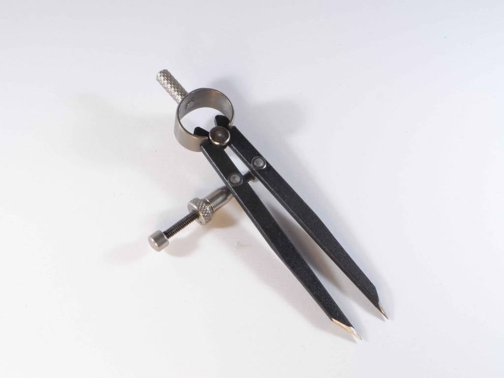

Among other things, I've gotten a couple of pairs of small machinist dividers. I grind the tips to the size I need. One set is ground for slotted openings- very common on Rolleiflex, for example. Another pair is ground for round openings like your example. A third pair is slowly disappearing as it is custom ground for new needs. Oh, one problem with this tool is that it was never designed to handle twisting motions. So sometimes I need to use pliers to hold the two legs in proper orientation while twisting if I need lots of pressure.

Good idea with the dividers. The pushpin tool intrigues me. Can you show a photo of that also please?

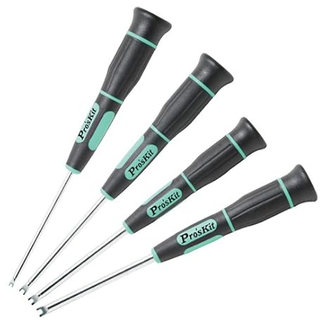

How about these? I think they should be available from some hardware stores: <see image above>
They rather look like they will fit screws with half slotted heads which you often find in toasters or hairdryers ! One of them (if very small enough) should fit the screws located on the rear side of the Rollei 35 top cover...

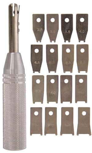

the right tool is a minispan wrench, but they're out of production.
the closest substitutes are spanner bits, aka "snake eye," "pig nose," or "twin hole." they solve the twisting problem of adjustable spanner wrenches or dividers, but you have to file the tips into shape because they aren't round. it takes a bit of work to get set up.
I'm sure it's possible to fabricate similar inserts at home with a minimal set of metal-working tools (and skills) but it should be the right kind of steel: neither too hard nor too soft. Experience is invaluable in judging it.
How are these bits sized - in what steps? What is the spacing of the smallest "fork" available?
