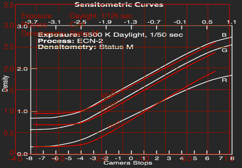

Interesting that Kodak 250D sure does have a lot of dynamic range !
Image below is from : http://motion.kodak.com/US/en/motion/Products/Production/VISION3_Color_Negative_Films/VISION3_250D/data5207.htm
1 -5.4 Stops 2 -2.3 Stops 3 +1 Stops 4 +1.5 Stops
5 +3 Stops 6 +4 Stops 7 +6 Stops 8 +7 Stops
