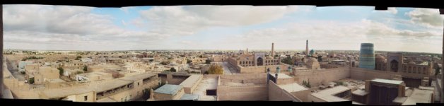

Hi,
I've done some panoramic experiments recently, taking 12 or so images using a 50mm lens and postprocessing the scanned images with Hugin and Autopano-SIFT. Here's the first result, a panoramic view of the old city of Khiva here in Uzbekistan. 🙂
attachment.php
The original is about 7000x1200 pixels, I guess I'll do some fine tuning and will have it printed for hanging on the wall... Unfortunately RFF's 900 pixel width limit is a bit suboptimal for presenting panoramic images. 🙄
I must say I really like the panoramic effect. I've done some darkroom panoramic work printing sections from 35mm and 6x9 negatives, but the digital version is quite nice, too, and has a lot of detail. The combined virtual "negative area" of this shot is probably like 35x140mm, a bit larger than what you'd get from an FT2. I guess I will do more of this eventually! Have you done some panoramic shots that you're proud of?

payasam said:
Tedious work, Philipp, but the results may be worth it. Is the horizon really sloped at both ends?
On the left it is, on the right it isn't. It still needs some finetuning, but that's fairly easy to do in Hugin.
The picture here is just from the most basic process: telling Hugin where the source images are, telling it the focal length of the lens, having it generate control points automatically, and having it stitch the final thing. Less than twenty clicks of the mouse and twenty minutes of computation on my laptop. No fine tuning done yet, so actually so far it hasn't been tedious work at all. It's a lot easier now than it used to be, in the good old times PTStitcher/PanoTools times, and a lot of fun to play around with 🙂
Philipp

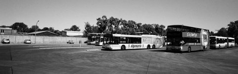

Here's another one, produced "conventionally" by cropping from a shot with the CV 21/f4:
attachment.php
The wideangle still works well here, but you see the difference between the rectangular projection here and the panoramic projection in the stitched images, which gives them an extra immersive effect, like you would get from a swing-lens camera...
